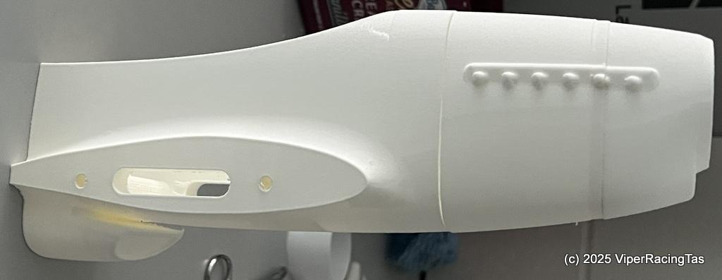

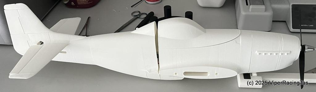

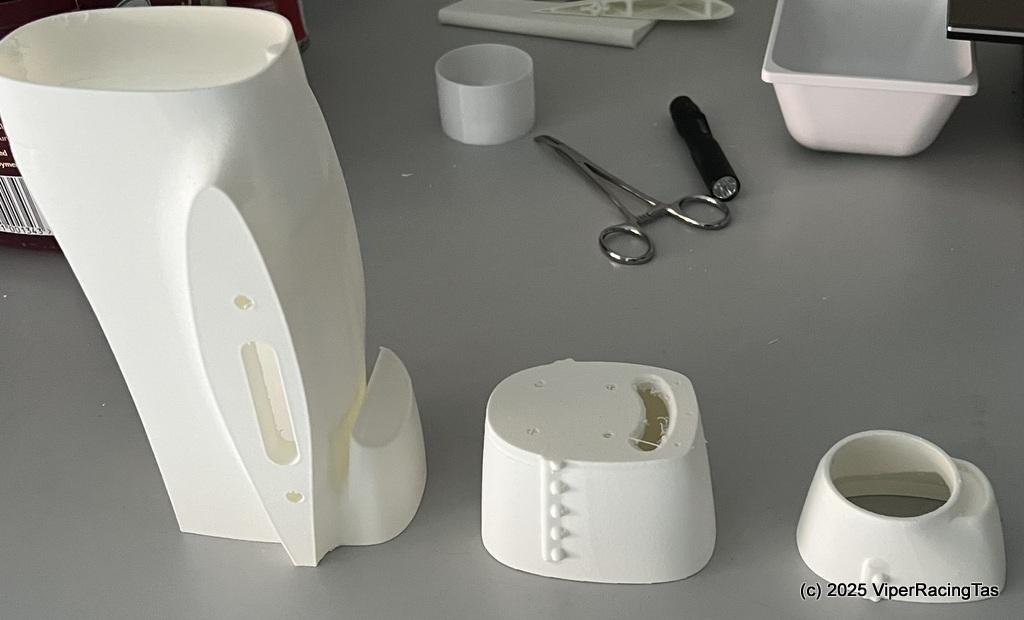

Looks like the weather isn’t improving any time soon & as I can’t finish the Zero till the motor arrives I have started on yet another build.
I’m sure those with a keen eye will be able to pick what it is from these first couple of pics.
First 3 fuselage parts
How it looks together

Maybe tomorrow I start to assemble a few bits & pieces.
The fuselage is finished. along with the tail, rudder & elevators so pretty much just the wings to print but I’ll assemble what I’ve finished first. Should have a spare motor around here somewhere to fit this one as it’s only a 680mm wingspan.
Looking more like a P51D Mustang every day
