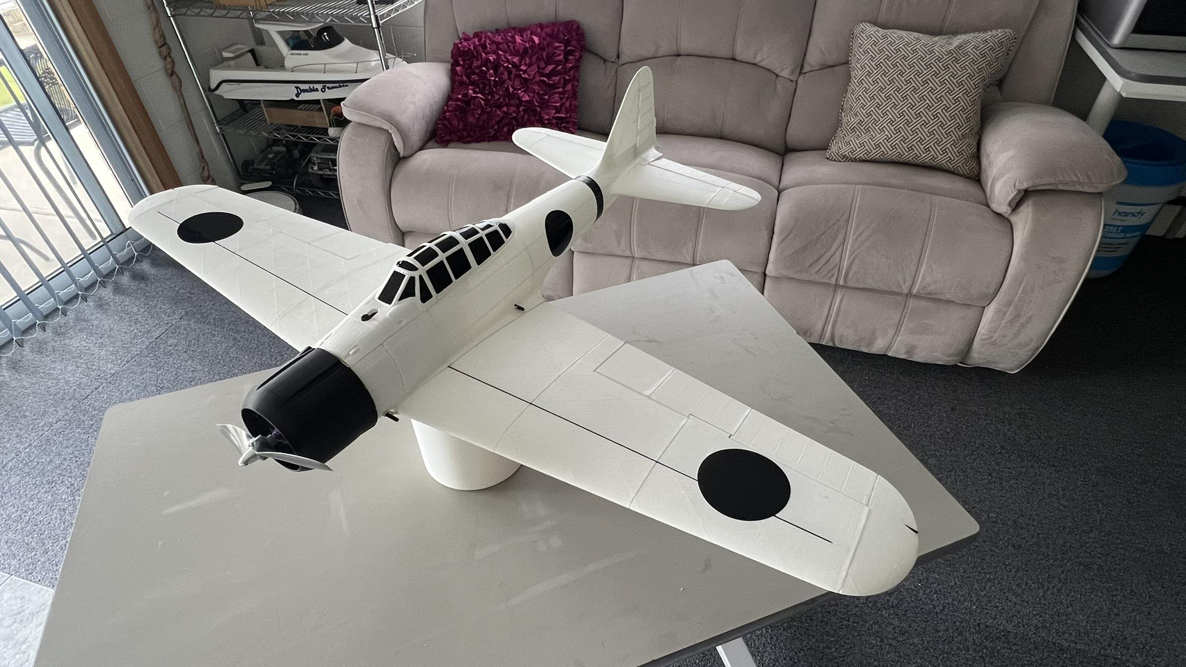

            Finally, my 3D printed Zero is completed, apart from the motor (which should be here in the next couple of weeks).
            I gave the entire plane a couple of coats of clear gloss Acrylic Enamel as this tends to toughen the LW PLA somewhat.
            All servos are in and set up along with the PWM ELRS receiver etc. Once the motor arrives & is installed I can tidy up the wiring & she is ready for her maiden.
            I modified how the wing servos fit, don’t like glueing them direct into the wing as 9gm servos are easily damaged & almost impossible to remove if glued directly into the wing.
            I will install some servo protectors as well before flying.
            My homebrew black logos have been installed in place of the red roundels
            Hopefully she flies as good as she looks !!
          • #20030
            Very nice indeed Mike.
            Are you going to print and install the under wing servo arm protectors?
            First belly landing might undo all your fine work with attaching the servos if you don’t.
