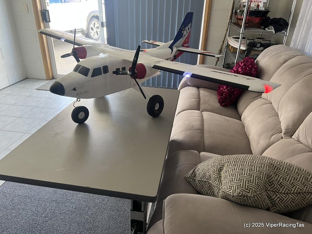

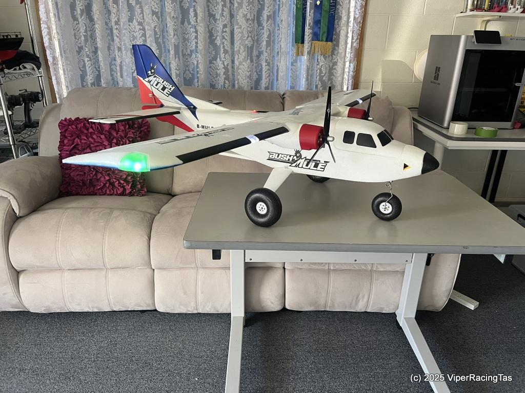

      Quite some time ago Ross (aka “Sheep Shagger”, “Bad Angel”,”MilkCrate” gifted me the remains of his rather badly damaged twin engined Sky Mule to see if I could rebuild it.
      Well after far too many hours gluing, patching, manufacturing etc etc, the Sky Mule (now renamed “MilkCrate Express” ) is finally ready to fly again.
      Along with all the repairs I have fitted a SpeedyBee F405 Wing mini flight controller, a long range ELRS receiver & set it all up to the Jumper T16 Plus transmitter.

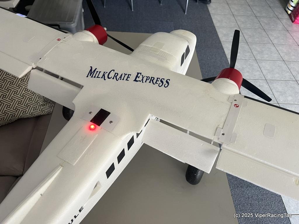

      I am just installing Vortex generators (14 of them) along the leading edge of the main wing to hopefully negate its (according to Ross) tendency to tip stall at the slightest provocation.
      I guess only the next flight will tell, one way or the other.
      Hope to test fly it on this coming Friday with a new 4S 3400mah 60C LiPo installed so I really don’t want anything to go wrong & damage the battery.

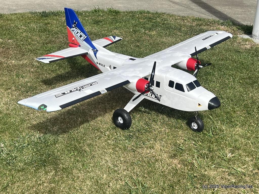

        Good repair job Mike. Unfortunately I won’t be able to see it fly on Friday.
      • #18710
        If tip stalling move CG forward, fly with less weight and check there is washout at wing tips.
