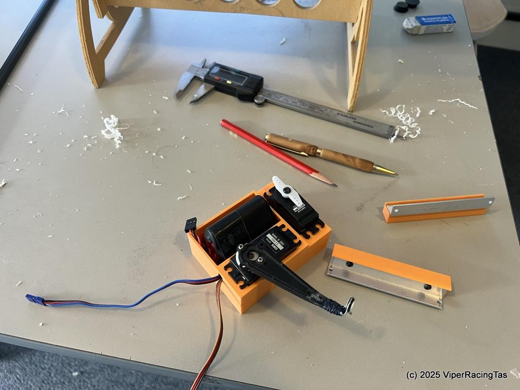

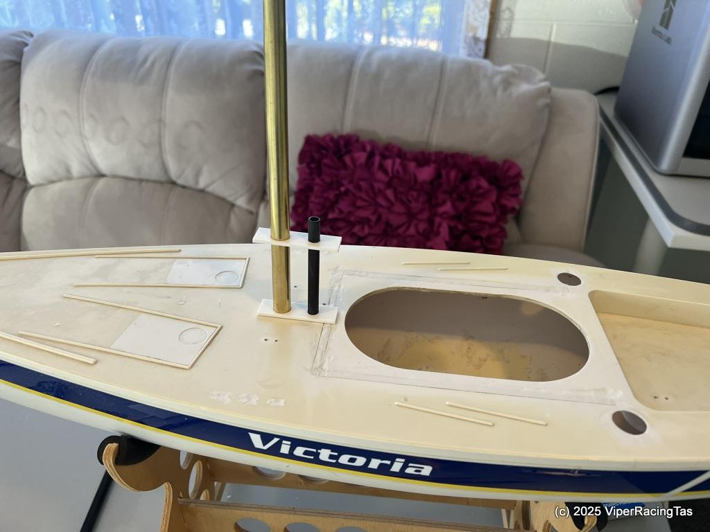

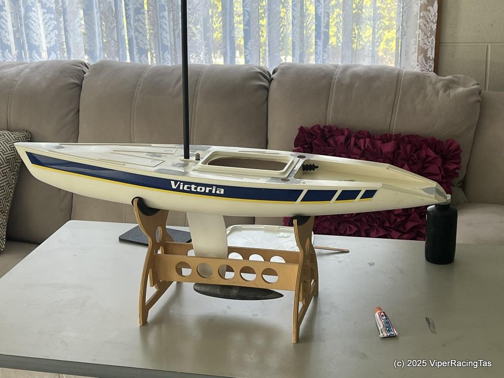

      To date I have 3D printed a Servo/battery box, waterproof hatch surround & cover (Tupperware style seal) and installed carbon fibre posts for the rudder & keel (epoxied into the hull & deck to waterproof) and a brass tube for the drop in Carbon Fibre mast.
      Below is the 3d printed jig to get the keel post & the mast parallel.
      I then printed a keel box (later filled with 24hr epoxy) to better seal the keel post where it penetrates the hull & to anchor the lower end of the drop in mast support.

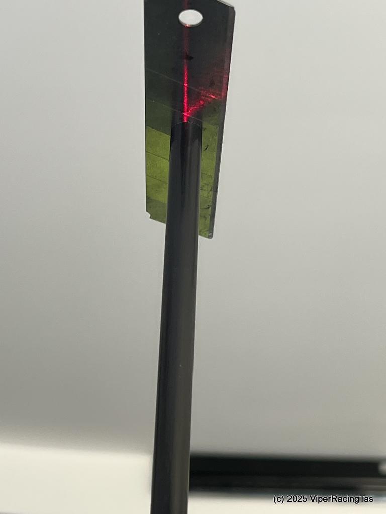

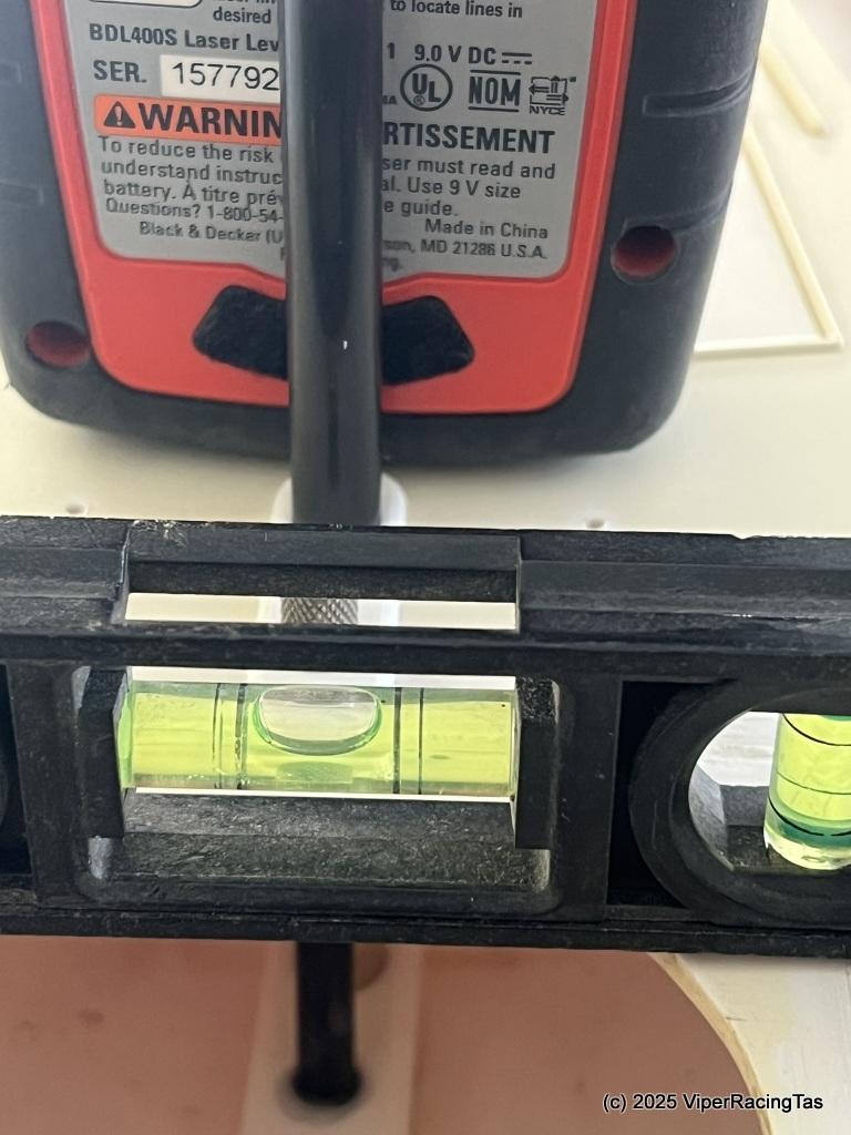

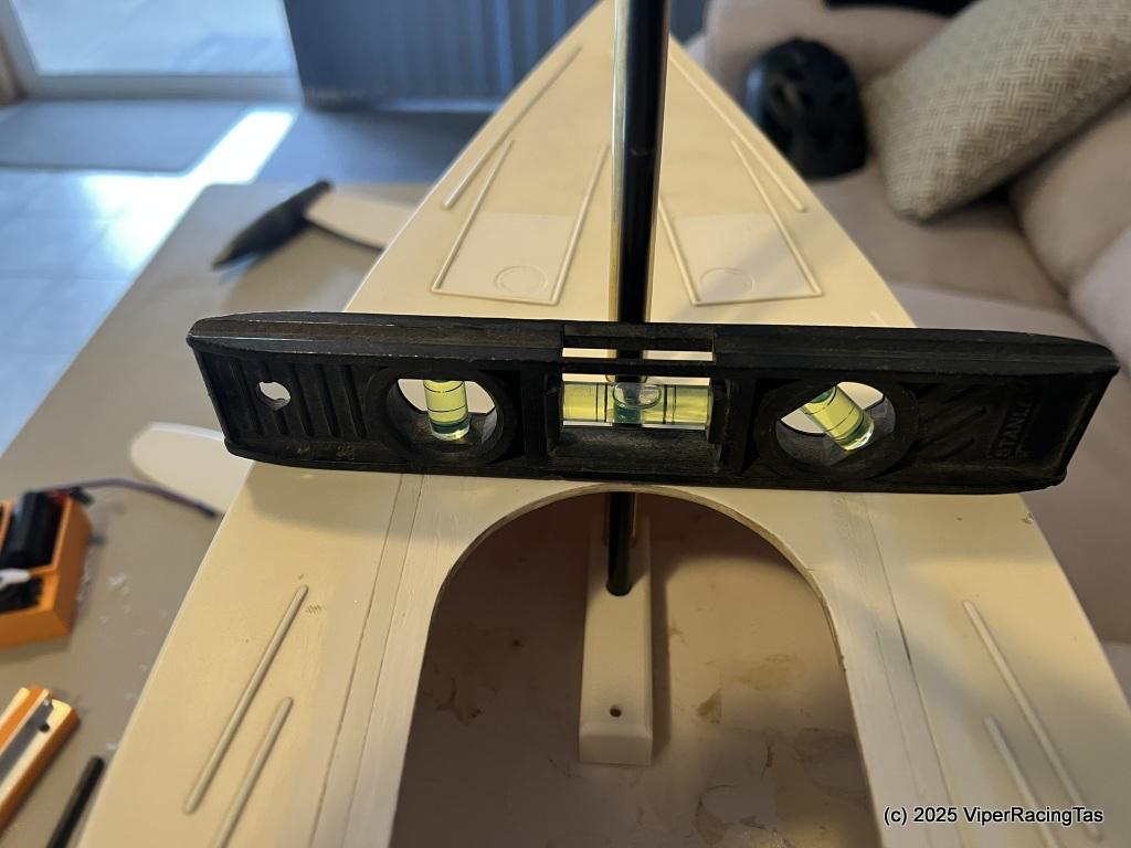

      The mast was then stepped (I think that is the right nautical term) and set straight with the aid of a spirit level & a self levelling Laser Level
      With everything plumb the keel box was glued into place with quickset epoxy & then with the mast support tube removed the box was injection filled with 24 hr self levelling epoxy. Once box was filled, the support tube was reinstalled & epoxied into the deck as well.
      After letting set overnight & checking all alignments today the mast deckplate & hatch surround were also epoxied in place.

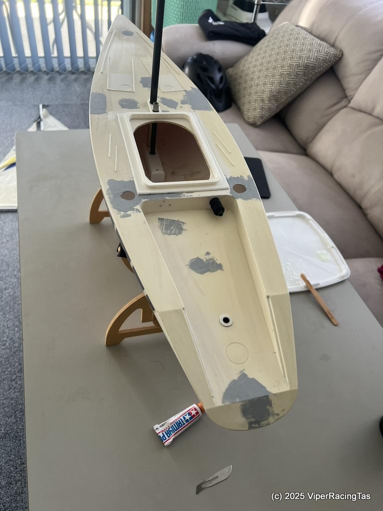

      I have started patching the redundant holes & imperfections in the deck & once they are sanded back ready for painting I’ll get the old original sails patched & installed ready for water testing in the next week or two.

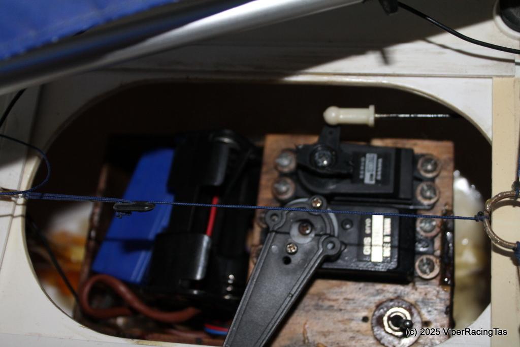

        After the kids took me out for a lovely Fathers Day breakfast, I headed home and got back into pressing on with the “Victoria’s Secret” build.
        As you can see from the photos I finished the design & 3D print for the Boom Vang, It’s very similar to the new DF65 design (why re-invent the wheel?) just upside down.
        The mainsail is now fitted (just a temporary old original one till I get round to new sails) and the sail-winch setup and functioning.
        I will run a second line from the winch for the jib as having two sheets makes for easier adjustments. There will eventually be two bowsies fitted on the rear deck to allow for easy sheet adjustment.
        In keeping with the minimum aloft weight possible I have used an IOM style crane for the back stay support & attachment of the main sail.
        The next job will be to install the Jib and finish off the sheets etc. That should be done tomorrow if this wet weather keeps up.
        Hopefully the bell crank for the rudder will arrive this week & then she should be ready for a test.
        The boat is now significantly lighter (with most of the weight gone from the mast & rigging). The minimum racing weight (according to the rules) is 2.04 kg and even with my heavy 5 cell AA NiMH battery installed it only now just scrapes in at 2.0kg, hopefully with the rudder & the jib & a coat of paint, it will make correct minimum weight without any corrector ballast.

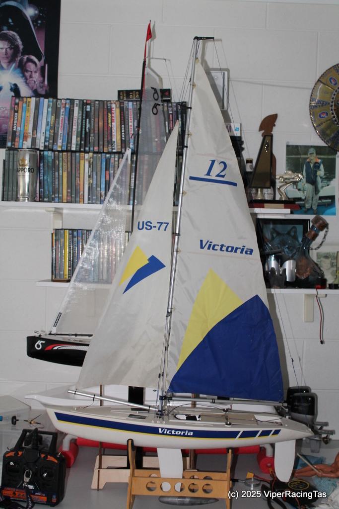

        Well then it’s finished good enough for testing.
        The original sails look & fit terrible but they will have to do if I want to get in the water this Saturday (weather permitting).
        If all goes OK the new sails will be next on the agenda then a full strip down (again) and repaint.

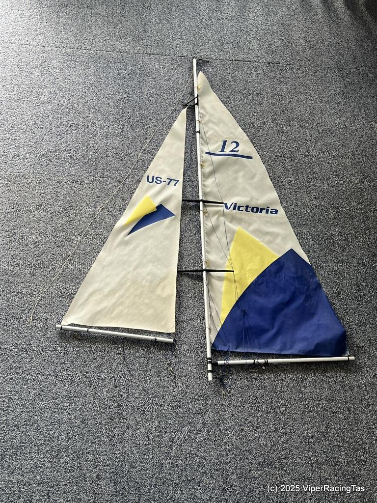

        I caught up with Kyle around Christmas and arranged for him to make me a set of compliant Victoria (One Design) sails when he had time in the new year.
        He delivered them about a week ago so I thought I’d better get them fitted & tested.
        I ended up re doing most of the rigging & up ending the boom vang to allow the new sails to fit correctly with the new CF mast & booms.
        Was quite a bit of stuffing around & I needed to reprint several of the parts but I’m now happy with the results.
        Hopefully I’ll get to sail this Saturday and if all goes well with the new setup I’ll just need to strip it all down again & paint the hull and “Victoria’s Secret” will be like a new boat.
      • #20745
        Nice looking sails Mike, a big improvement over the originals!
